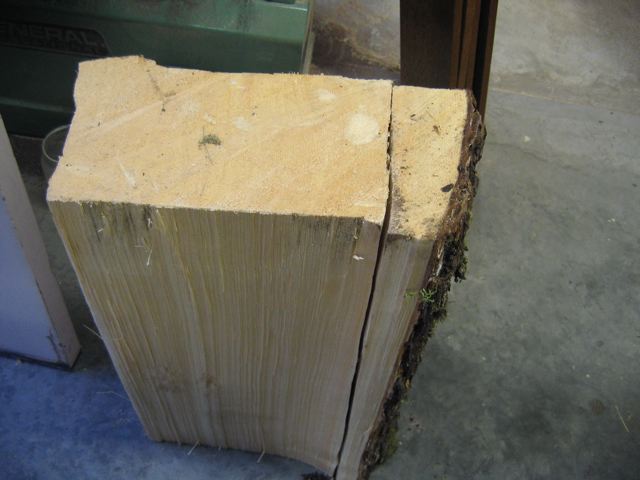

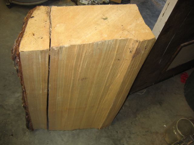

I still have a few 'technical' questions that I need to research about processing tonewood. They might not change the way I do things but they might help me explain why I do certain things. Along that line I am starting to investigate the issue of drying and 'seasoning' wood. I think most of us understand the concepts of 'free' water and 'trapped' water, for a lack of the technical terms. Free water would be that which is outside of the cell walls and trapped is that which is inside the cell walls. We would, in general terms, call wood that has been dryed wood that has very little free water, and wood that has been seasoned wood that has the moisture largely removed from within the cell walls. Now I am speaking from memory of biology classes from 20 years ago in College, so I can be easily corrected here and I am going to review Hoadley's great book on this stuff. But what got me thinking more was that all of the wood inside the sapwood layer should be dead. Like I said I need to look into this a bit more. We do know that in the the spruce that I harvest that the inner portion of the tree is much dryer than the sapwood portion. So, is the inner portion, the heartwood, remaining moist because it is covered in an envelope of water and is therefore unable to dry further or is it still somewhat vasular? How much trapped water remains in cells that are no longer active and have been laying in place for a few hundred years? Anyway, to start down the road to getting answers to these (and a few others that are rattling around in my cranial cavity) I measured and weighed a couple of pieces of wood that I pulled from the bush yesterday (the last of the current tree is home now!!). Here are the pieces:
So when I measured and weighed these and compared them I found the following:
The sapwood weighed 13.05 g/in3 and the heartwood weighted 7.32g/in3. Sorry for the use of mixed measuring systems but that seems to be the way it is most reported in the lutherie circles! So that means that the sapwood is 1.78 times heavier than the heartwood by volume (I even included the bark which if removed would make the difference even greater!). Anyway, I will be looking at this further but would love to here more thoughts on this. Just for reference dries tops leave here usually about 3.7 to 4 g/in3, depending on the tree and how long I have had them. This current tree was felled on 3 June 2007. Off now to run sound for a freinds band in neighbouring community!!

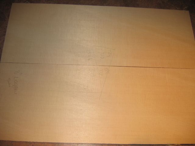

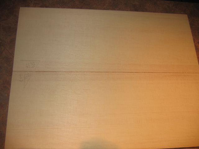

I went and measured up a couple of sets from my stash. The weights are indeed higher than I indicated in my first post.
This set weighs 416 grams and when placed together as a pair measures .370 x 7.875 x 21.75. So it weighs 6.56 g/in3. It has about 24 grains per inch.
This set weighs 481 grams and when placed together as a pair measures .391 x 8.5 x 22. So it weighs 6.58 g/in3. It has about 16 grains per inch.
These sets are from two different trees from two different watersheds but the same regional area and are both Lutz Spruce. So I think my math is right and these sets are quite dry, the trees being down for over two years and the sets re-sawn for a number of months to over a year and stored in a heated area with about 50% humidity.
What is interesting now is that the heartwood from the tree mentioned above is only about 10% heavier than these dried sets and it has not been resawn dried and stored yet. Another thing to think about!!
Shawn, The sapwood on this tree actually has wider growth rings than the heartwood, that is not typical from my experience. Another interesting note from the trees above is that the tighter ring spacing produced the lighter in weight wood. And I think some of the first sets you got from me had ring spacings in the mid 40's and was even lighter than this wood shown. So probably the size of the dark rings (they are larger in the wider grained wood) may add to the weight as well. So it might be the accumulated width of dark grains that contributes to the weight. Is any of this important? Not sure but it is interesting to look at and may help people in determining what they would look for when selecting their tops and should definitely be part of the notes recorded when building guitars, they are recorded in my guitar making journal!
